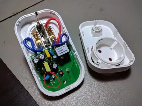

I've been buying Sonoff smart plugs on eBay lately and flashed them with custom firmware. This is possible because they are based on the ESP8266. They are very affordable and pretty advanced.
They need to be opened and a pin header soldered onto the PCB, then you have to program them with a FTDI adapter, which you can also get cheap on eBay. It's pretty straight forward.
When flashed they connect to my WiFi network, and sends and receives MQTT commands. I'm using Home Assistant for this.
BRUH Automation has a video about them: https://www.youtube.com/watch?v=-JxPWA-qxAk
