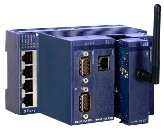

Industrial Grade and Easily Scalable
If you want an industry grade device that's not targeted to be sold to home/private customers, then check out the eWon products. In particular I can vouch for the Flexy models scaling from 10 or 100 data points and/or IO mappings, etc. There is more than just the Flexy though so check out their other products from their Product Gallery that may be even better suited for your need.
Secure and TCP/IP Network Accessible
You can connect to these things via a secure SSL HTTPS web interface, via a VPN client connection, or make URL API calls to return data or push data to trigger an ON or OFF for instance. I'm sure there's functionality I've not fully discovered with these things still but they work well and seem to fit the criteria you ask in your question.
You configure your device for access to a data network via Ethernet or wi-fi, and these other methods of communication as listed on eWON Flexy Extension Cards.
.NET App
You can have your .NET app make the URL API calls with the arguments passed in accordingly so I can say 100% for sure I know this is possible too.
Support
This product has good technical support and the price is not that bad either for what you get so it's worth the read at least, and be sure to check out Talk2M - Industrial cloud for remote connectivity
The eWON Flexy uses an outbound connection across the factory LAN (HTTPS port 443 or UDP 1194). This makes the eWON Flexy to be isolated from Internet by working with private IP address, non reachable from the Internet. No IT/firewall changes are needed to establish communication. A key asset that your IT team will appreciate!
All connections run through industry standard VPN protocols to guarantee a safe and secure connection that prevents network intrusions.
Source
