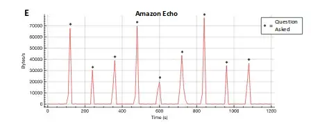

According to the recent paper A Smart Home is No Castle: Privacy Vulnerabilities of Encrypted IoT Traffic, many smart home devices can be 'fingerprinted' by their connection patterns. Since most devices connect to a small set of URLs when they're invoked, it's possible for an attacker (or an unfriendly ISP) to determine when you use each device.
For example, they tracked the traffic going to the Alexa servers from a home router (the URLs they used are in Figure 1 in the paper):
Alexa Traffic Pattern
They also show that a similar principle can be used to determine when a sleep monitor is used (and hence when you wake up/go to sleep), or when a smart switch is toggled.
Clearly, it's disturbing that you can get so much information from a device, despite it being encrypted. It seems harder to get much information from computer traffic, because the servers accessed are much more diverse, but for an IoT device that only 'calls home' to a specific server, it appears easy to track which device was used, and when.
Since many countries store metadata such as this, it's feasible that they would be able to use this method themselves to determine your activity, and the same amount of data would be leaked to any network-level attacker.
