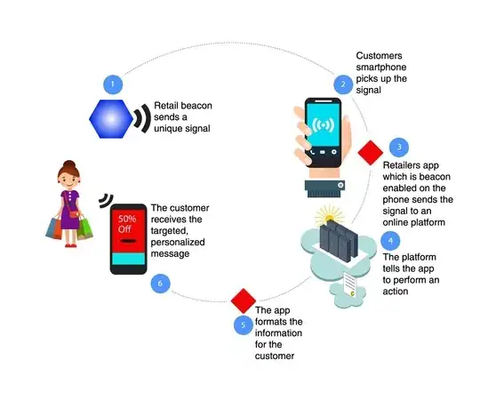

We are planning to implement a proximity beacon network which provides information to the users app based on proximity in the store. Our objective is to cover a radius of 5-7 metres.
Which protocol has the better connectivity between the beacon and the iOS/Android app?
The Network will be as below,
process flow of customer using a beacon
To clarify, we are focusing on Eddystone over the other protocols because of Google. Considering the current situation in beacon technology, is there a better alternative for communication with mobile applications? If there are any, what is the advantage over Eddystone?
