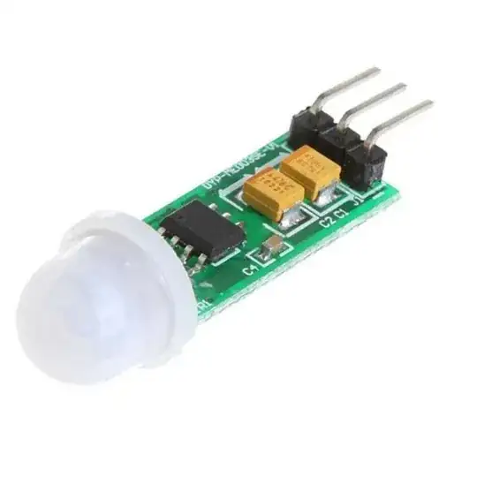

I want to build a home automation system by hooking up various sensors (e.g., passive IR motion sensors, magnetic door contact switches, vibration detectors, etc.) around the house to detect things then send the sensor signals to a central command center / control station.
PIR Motion Sensor
PIR Motion Sensor

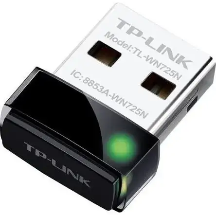

Apparently, a USB wireless adapter or a network adapter might be the component I'm looking for. But would it be possible to build up a separate breadboard circuit for each sensor and pipe all the signals to the wifi network? If so, how? I want to keep my budget to about $10 per sensor.

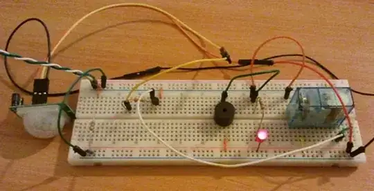

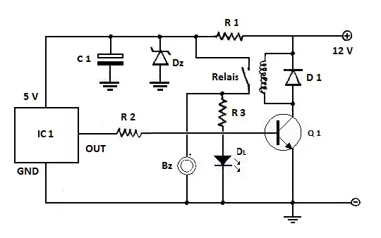

I found this article which reflects what I'm trying to do with the sensor. But it says nothing about a wireless (analog-to-digital) conversion.
PIR Motion Sensor Schematic
Breadboard Hookup
Breadboard Hookup

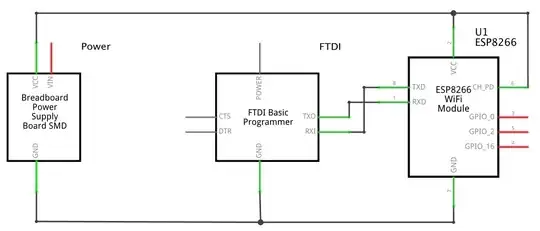

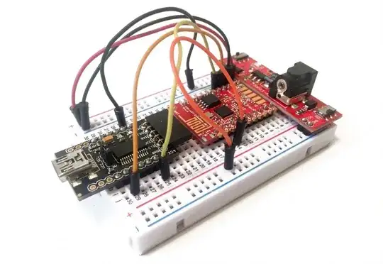

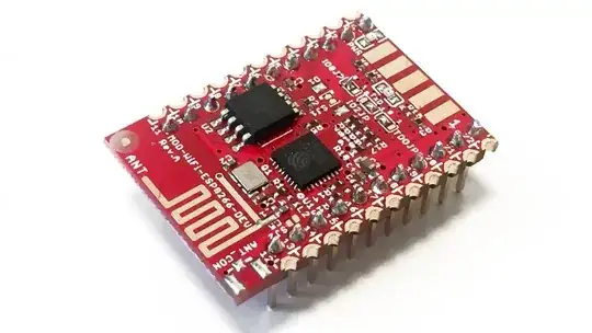

I like the suggested ESP8266 chip described here. (Could this really be $ 5-10 per sensor?)
ESP8266 chip
ESP8266 chip
Breadboard configuration
Schematic
Schematic

enter image description hereesp8266 is good if you want to operate system through internet otherwise Prashanth Benny is right you can use radio modules for easy of access and less budget.
esp8266 module is only transmits serial data to other wifi enabled device but it requires a micro-controller

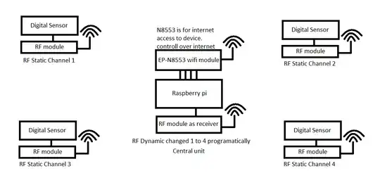

so according to me, use radio modules(RF modules) and about sensors use digital sensors in place of analog like digital PIR sensor you can control digital PIR using pot switches.
And at the other hand receive all sensors data using other RF module this module is a part of central system.(see picture)
