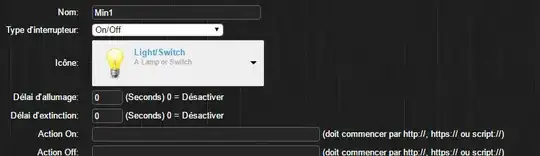

Domoticz dummy switch
Domoticz allows to create a dummy switch which can change states after some time given in an interface :
Pros
- off-the-shelf timer!
- I can interact quite quickly between my wall switch and the lamp
Cons
- although Domoticz handles MQTT, there will be a lot of LUA script and "blocky" to interconnect devices
- time might not be easily configurable...
