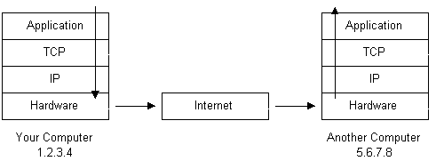

One way to think of the TCP/IP protocol suite is as a specification for how processes running on different systems and different networks can communicate with each other. In essence, the TCP/IP protocol suite provides a standard for inter-process communication.
Any system that correctly implements the TCP/IP protocol suite may use the functionality it provides to allow its processes to communicate over the Internet. In fact, in order for processes to communicate over the Internet with other processes running on remote systems on other networks, a system must utilize standards-compliant TCP/IP suite protocols.

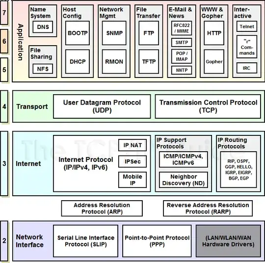

This question exposes the poor depiction of the TCP/IP protocol suite in the diagram in the article linked to in the question. For reference, here is the diagram:
Shitty TCP/IP diagram
The lowest layer, referred to as "hardware", should be referred to as the link layer, media access control (MAC) layer or the network interface layer.
From IBM's "TCP/IP Tutorial and Technical Overview" page 34:
The network interface layer, also called the link layer or the data-link layer, is the interface to the actual network hardware. This interface may or may not provide reliable delivery, and may be packet or stream oriented. In fact, TCP/IP does not specify any protocol here, but can use almost any network interface available, which illustrates the flexibility of the IP layer. Examples are IEEE 802.2, X.25 (which is reliable in itself), ATM, FDDI, and even SNA.
Here is a correct and superior depiction (from The TCP/IP Guide):
Superior diagram of TCP/IP stack
The reason that discussion of the network interface layer is relevant is that it is at this layer that there is a difference in the way a cellular/mobile device connects to a GSM network vs. a WiFi network.
  • when connecting to a GSM network, the network interface layer protocol employed to handle the connection between the mobile device and the base transceiver station (BTS) is typically specified by 3G
  • when connecting to a WiFi wireless access point (WAP), the protocol used is specified by the IEEE 802.11 standard.

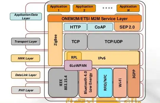

The TCP/IP protocol suite and Embedded Systems ("IoT")
While there are a variety of different applications utilizing different application-layer protocols running on traditional PCs or servers, there is not that much variance in terms of how the hardware platforms connect to their respective access points (network interface/data link layer). It is primarily accomplished wired or wirelessly via Ethernet.
The situation somewhat different when it comes to the wide variety of embedded systems that communicate via TCP/IP. Here is an illustration of this (from Postscapes):
IoT and TCP/IP 1
IoT and TCP/IP 2
