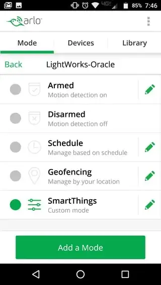

This ended up working for me:
  • Create a new mode in Arlo app. Have it do any recording or notifications
  • Connect Arlo to SmartThings (using Arlo Connect SmartApp)

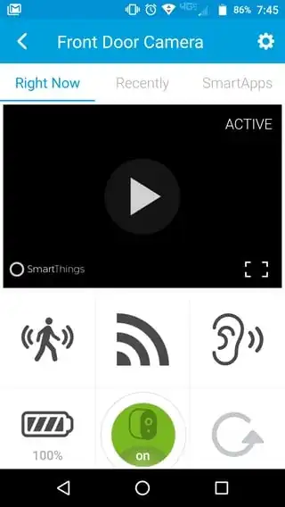

  • Select each newly added Arlo device and set it to Inactive (click the green camera icon from status screen of Thing)

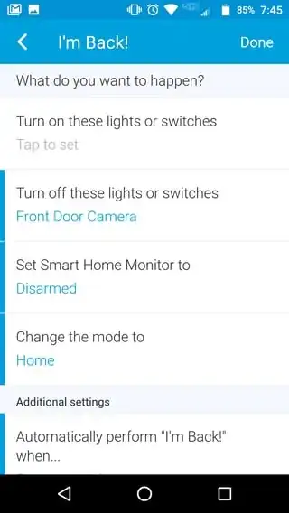

  • As needed, update Smart Home Monitor routines (ie Good Morning!, Good Night!, Goodbye!, and I'm Back!) to turn off/on the cameras as switches

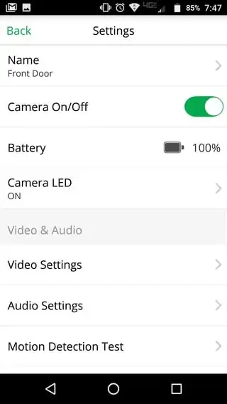

By turning off/on the camera as a switch in SmartThings, it is essentially the same as turning off/on the Camera switch when configuring camera settings through the Arlo app.
Configuring SmartThings/Arlo Camera Status (only needs to be done in SmartThings) SmartThings Camera StatusArlo camera configuration
Configuring automation routines. Activating in SmartThings, tasks are handled in Arlo mode: Setting the Smart Home Monitor routine in SmartThingsSetting the Arlo mode to SmartThings for recording
