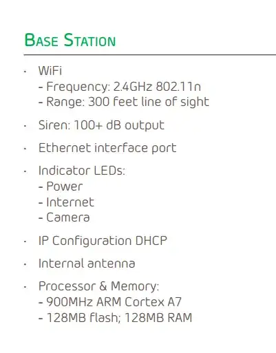

Based on the information in the product datasheet, this device communicates wirelessly via 802.11n-compliant protocols over a 2.4GHz channel.
