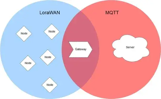

Imagine your network as a Venn diagram where one set is LoraWan and the other is MQTT.
Elements in the sets should know only about their set(s).
  • So nodes using LoraWan (are in the LoraWan set) do not have to bother with MQTT or with the server. They just send/receive data to/from the Gateway. The Gateway is the end of their world.
  • The Gateway is in the intersection of the two sets, LoraWan and MQTT. The MQTT related part should be hosted here as this element is part of both sets. Its task is to forward the collected data from the LoraWan nodes to the Server by publishing the appropriate node data to a specific MQTT topic. The logic that distributes data between the correct MQTT topics should implemented here.
  • The Server could host the MQTT broker as is is in the MQTT set and and has nothing to do with LoraWan.
If you are looking for a LoraWan compatible server and you have LoraWan enabled nodes, then I do not understand where do you need your Gateway. The Gateway is supposed to provide interoperability between two different networks. In your case between a LoraWan network and a TCP/IP network or the Internet.
