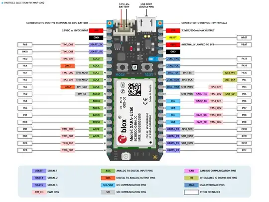

The Particle Electron has three free UART lines of which you can use one to connect an ESP8266 based Wi-Fi module.
Particle Electron Pin Map
The ESP can be controlled via AT-Commands which is not that difficult to use. The manufacturer provides a lot of document to help you getting started.
