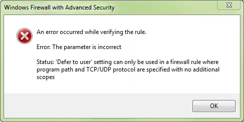

First I have received the following error.
Picture of windows firewall error message reporting wrong parameter
  1. To solve it, the Edge traversal settings has to be modified on the Advanced tab. I have changed it from "Defer to user" to "Block edge traversal."
Conclusion. It does not work, I cannot connect to the broker from the 192.168.1.5 address. It is all the same if I select the "Allow edge traversal" option.
Once I switch back to the "Any IP address" my client connects without any problem.
What's wrong?

Could you make custom rule by typing the ports (1883 and 8883) and allowing separately with different rules both UDP and TCP on these ports.
See: https://technet.microsoft.com/en-us/library/cc947814(v=ws.10).aspx
This post says you need the described hack that did not work in your case to change the defaults by program name.
