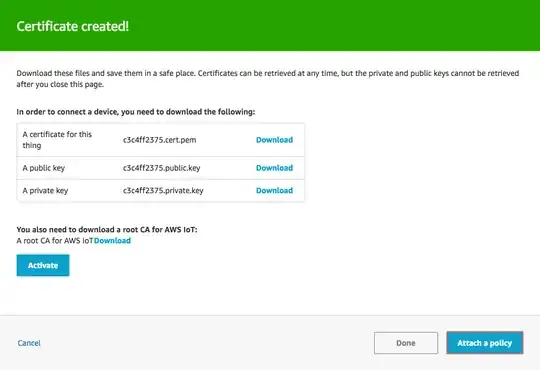

When you create a device certificate on AWS IoT, you should see an image like this:
AWS IoT
(source: amazon.com)
Image from the Create and Activate a Device Certificate page of the AWS IoT documentation.

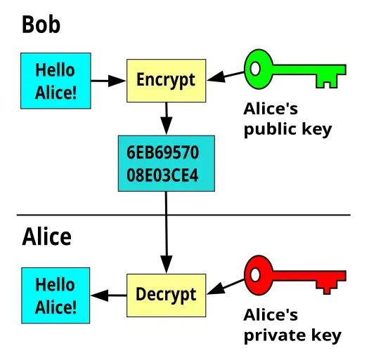

The private key is the thing you really need to keep... private, and should definitely be stored on the read-protected memory if possible. The public key and certificate are designed to be shared, so if you're running out of space, you can safely move those to external storage. You can get a little bit more context on the page How does SSL/TLS work? at Information Security Stack Exchange and Public-key cryptography on Wikipedia. I think I'd be doing you a disservice if I didn't include this image to explain why the private key needs to be secret:
Public key cryptography.
Image from Wikipedia, released into the public domain.
Your device's public key is what AWS IoT uses to sign messages to send to your device (but it does not prove who is sending the message). So, really, it's not a huge disaster if someone steals the public key, because it's not meant to be a secret.
The private key is what your device uses to decrypt messages, so it's a slightly bigger problem if an attacker steals this.
