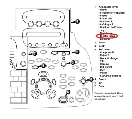

I think I know what you mean - they're different color maps in lieu of the usual grayscale. I've very rarely seen them used by physicians and it is impossible to find screenshots online (sadly these days I don't have access to an ultrasound station).
From the GE Vivid 7/Vivid 7 PRO User's Manual:
Same manual, page 94
Color maps Displays a color map menu to optimize the greyscale presentation. The menu enables an option from a list of nonlinear gray-curves or different 2D-colorized curves to be selected.
