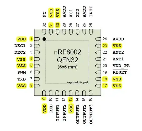

How to given power for nRF8002 chip?Pin 1-4 used for supplying power,but i didn't know the how power is given(1.9 - 3.6 V).nRF8002 development kit is the only solution for configuring this soc?

    It sounds like you probably have some sort of module as those pin numbers don't match the datasheet. You should mention what it is and give a link to a datasheet or product information. – PeterJ Feb 12 '14 at 06:28

    That IC SoC has 17 power pins, and yes, they all have to be connected. If you don't want to buy a dev-kit, you will have to have a custom PCB made for the IC. – Connor Wolf Feb 12 '14 at 10:35
If you don't want to use a Development Kit you will need to design your custom PCB for that IC.
To power the IC you will need connect all power pins as said the datasheet:
Where VDD is the Power (1.9 - 3-6V) and the VSS is the Ground (0V).
The recommend voltage to this IC is 3.3V, and have a lot of switch power supplys designs for this voltage, you can use this tool to create your own, with BOM, schematic and PCB if you want.
