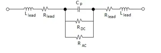

The problem is more serious than you describe, because there is not just a capacitance but an inductance and resistance as well, that are changing all your design at their resonance frequency. A nice tool to calculate the capacitance of two parallel wire is the QuickField and you can download the Student Edition for free.
In PCB traces some typical values for capacitance and inductance are
As you can see there is a big problem especially in high frequencies. This parasitic elements are everywhere, and engineers must taking into account according to the application main parameters (frequency, voltage etc). You can see bellow the main passive elements non ideal equivalent circuit that introduce limitations in using them .

Wires and Transmission lines
Smaller component sizes usually result in smaller parasitics. With today SMD passive components on PCB allow for several GHz safe design. In wires, transmission lines technics are using (coax, twisted pair, ribbon cables, twin lead, microstip and stripline…)
