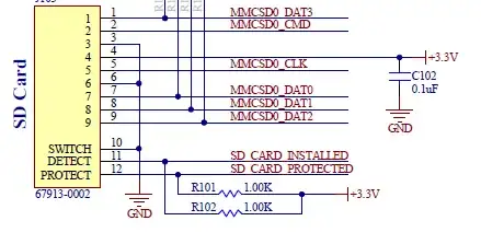

SD Card wiring
A circuit in front of me wires the "SD Card Protected" line from the card cage (in this case, full size) to a GPIO port and the driver detects that. The picture above is to emphasis that the "card present" and "card protected" mechanisms are seperate from the MMCSD data transfer bus.
In your case the microSD card has no switch and no mechanism on the card slot to detect anything. Without looking at the BeagleBone schematic, I'd say there's no Protect line. But, that doesn't prevent you from
  • Creating your own card protect line using a spare GPIO line and using a jumper to select protected/not-protected. Then changing the SD device driver to use that GPIO line.
  • pretending a line does exist by altering the SD device driver
  • Not bothering and asking the kernel to mount the image read only
So I'm afraid the question reverts to a linux OS question.
