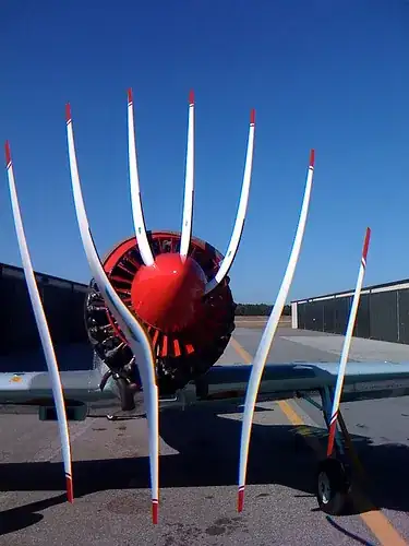

Not exposing the whole sensor at once can cause some "interesting" distortions.
Image below taken with an iPhone 4 with rolling shutter - from this
superb description of rolling shutter distoprtion effects

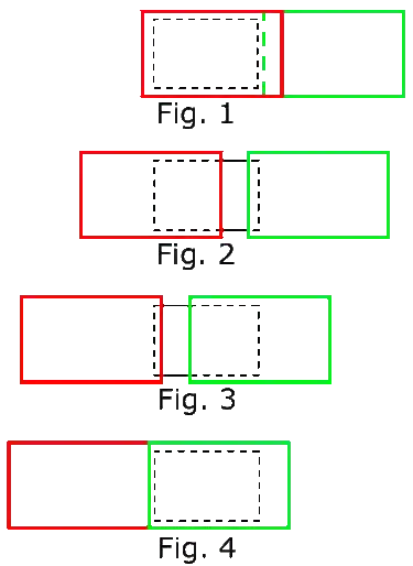

From the above page:
Slow speed operation.
1st/red curtain opens fully before 2nd curtain starts.
Rolling curtain width is whole sensor width
High speed operation.
Red / 1st curtain starts to expose sensor but green/2nd curtain follows it before it has crossed sensor so there is a window or slit moving across the sensor. The rolling curtain width is the distance between red and green edges.
