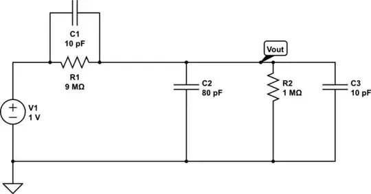

I've not been able to simulate and see the actual effect on measured signal spectrum. I have calculated that the impedances in parallel branches Z1 = R1||C1, Z2 = R2||C2||C3, and Z2/(Z1+Z3) should be 0.1.
I used Micro-CAP10 evaluation copy to simulate it, but I am getting weird results if I plot this quantity (Z2/Z1+Z2). I don't know what results CircuitLab would give.
Below is the equivalent schematic I used in Micro-CAP10.
schematic
Edit: The equivalent circuit is like 10MΩ shunted with ~14pF. So, the equivalent load on measured signal is reduced to 14pF. But it's not clear to me how one arrives to this equivalent circuit. Is there anyway to find the equivalent circuit of a more complex RC?

You need to establish that the ratio of series resistor to scope input resistance is the same for the capacitors. If series resistor is 10x bigger than scope resistance then series cap needs to be one tenth of cable and input capacitance. If using microcap look at the spectrum of Vout and it should be flat.

  • In Micro-Cap i plotted impedance, it shows flat response upto Ghz range.this looks not correct. I have edited the equation, by adding equalent circuit of the probe+Osc in to be 10Mohms shunted by ~10-14pF...how they have arrived i am not sure – user19579 Jan 26 '14 at 00:36
  • i would recommend using AC analysis and looking at v out. – Andy aka Jan 26 '14 at 01:06
  • AC analysis at Vout is giving flat response up to 20G – user19579 Jan 26 '14 at 23:11
