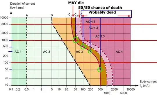

Added 2020:
This chart (source shown on right hand margin of image) shows combinations of time-current which may cause various effects, ranging from perception through death.
I'd err on the low side when deciding what might be harmful.
Note that (Ventricular) fibrillation usually kills if not reverted promptly.
The orange AC4-1 zone suggests a 5% to 50% chance of fibrillation.
The suggested boundary conditions for potentially lethal AC4-1 include
  • 50 mA for 1 second, or
  • 100 mA for 500 ms, or
  • 200 mA for 250 ms, or
  • 500 mA for 50 mS.
The lowest current suggested to possibly cause death is about 30 mA (for > 5s).
Aim for lower or none of any of these examples.
