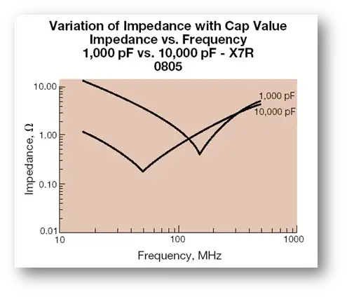

Look at the closely coupled power plane pair as a very wide transmission line (very low impedance). Remember a discrete capacitor has a resonance frequency around 100MHz or less.
If you recall the formula for going from bandwidth to rise-time: BW = 0.35/t_r it is obvious that a discrete capacitor will have a "rise-time" in the order of 3.5ns or more. That corresponds to more than 50cm on a board. Most boards are about that size or smaller, so pretty much anywhere on the board will be okay.
