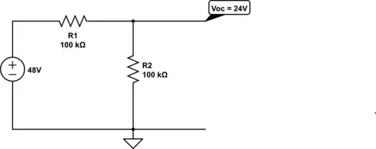

Very basic question. Assume a voltage divider where both divider resistors are equal value, i.e. 100K. If 48v is the applied voltage, it's easy to see that we'll measure 24v across the "load resistor". However, when we add a load in parallel with the load resistor, doesn't this parallel circuit reduce the total resistance across the load resistor causing the output voltage to be less than the desired 24v? Thanks for enlightening a non-engineer!
Indeed it does. Perhaps the most illuminating way to see this is to form the Thevenin equivalent of the voltage divider (without the added parallel load).
The actual circuit:
schematic

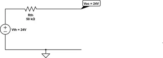

The Thevenin equivalent circuit is
schematic
simulate this circuit
By Thevenin's Theorem, the voltage across an added load resistor will be identical for both circuits.
It's easy to see in the equivalent circuit that an added load \$R_L\$ forms a voltage divider with the equivalent resistance and so, the voltage across \$R_L\$ must be less than 24V:
$$V_L = 24V \frac{R_L}{50k\Omega + R_L} \lt 24V $$
