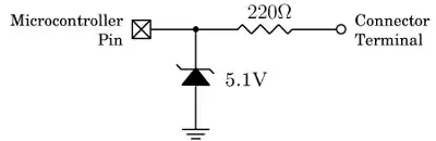

IO Protection
What you are looking for is a "voltage clamp" or perhaps a polyfuse or similar.
Arduinos also have this problem of unprotected IO. There are variants that include better protection which seem to me to be a useful example
From here
"Every I/O pin is protected by a 5.1V zener diode and 220 ohm 30mA PTC (resettable fuse). The equivalent circuit is shown in this figure" enter image description here
You'd have to adjust component values for a 3.3 V microcontroller or SoC such as the Rpi.

  • I've read about PTC polyfuses, starting from wikipedia to get here. Does the schematic above mean that both the Resettable fuse and Zener diode provide protection for the MCU's pin, as a kind of "double protection"? And then to achieve the protection I should get the 3V3 Zener diode and/or a Resettable fuse? – user35041 Jan 03 '14 at 14:22
  • A heavy transient will cause the zener to conduct once its breakdown voltage is exceeded. The resettable fuse will limit the zener current and if the zener current becomes too heavy, will go high-impedance and isolate the transient source. You need both for the protection to work. – Adam Lawrence Jan 03 '14 at 14:28
