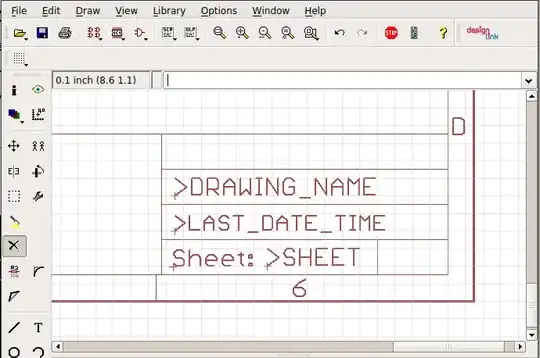

  • Enter the name you want to change "DRAWING_NAME" for example
  • Enter the value you want displayed "Awesome Schematic Name" for example
  • If you want custom attributes, edit the symbol and add your own special fields by using a greater-than symbol like ">PROJECT_NAME"

I use the smash command on the frame, then I delete the info in the fields I don't want and put whatever in there..
  • Select the smash tool after you have chosen and placed your frame
  • click on the bottom left corner of the frame (you'll see the x if you zoom in) to free up the title block text
  • then change it, select your size and layer and presto.
