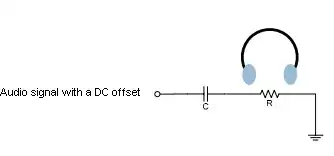

Lets say I have an audio signal with a DC offset and I want to use my earplugs to listen it clearly. Since I'm a human my hearing range is 20Hz to 20kHz. It means I need to filter very low frequency components i.e where f<20Hz. It means the cutoff frequency for the simple high pass filter circuit in my figure must be such that 1/2*piRC=20Hz. Here I need to know the impedance of the head phone (shown as R in the figure) to choose a proper capacitor.
At this point I'm confused:
My question is how can I measure this impedance? By simply using an ohmmeter? But what if it has different impedances in different frequencies? Should I apply an ac signal at a particular frequency and measure its impedance? Is headphone impedance pure resistive?

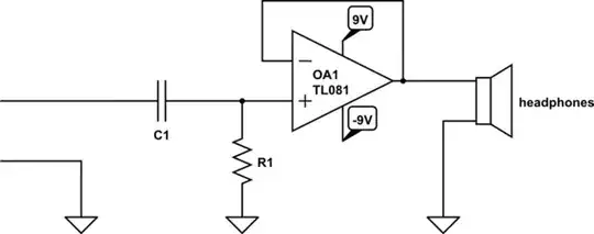

Relying on the headphone impedance for filtering is probably a bad idea. Different kinds of headphones will be significantly different. Even different instances of the same model of headphones can be different. The headphone impedance isn't just resistive but also reactive, and it will take some work to characterize it. Someone might plug your thing into a line input, instead of headphones, and expect it to work.
Instead, consider buffering the output. For headphones, an op-amp will do. You can, in fact, find tons of designs online for "headphone amplifiers". Some of them even use very expensive op-amps from Burr-Brown costing $50 or more, and, I'm told, these sound better than unobtanium flux linkages. Personally, I just use whatever op-amps I have in the parts drawer. Anyway:
schematic
Now calculating C1 is easy, because you also get to pick R1. Just make it anything significantly bigger than your source impedance. Make C1 whatever you like to get the desired frequency response. The headphone impedance is largely irrelevant, because the output impedance of OA1 is so small.

  • whatever op-amps I have in the parts drawer so long as the GBW is beyond band of interest, and it's unity gain stable. :-) – Anindo Ghosh Nov 27 '13 at 15:16
    @AnindoGhosh don't feed the audiophiles. – Phil Frost Nov 27 '13 at 15:17
    Relevant anecdote: I once had a SOT23-5 op-amp in my samples drawer, so for some audio quick & dirty buffering, I figured "How neat!". When the output consistently sounded like lions gargling with soap water, I checked the GBW. TLV2241, 5.5 KHz. Till that day, I had never thought an op amp could have a GBW that low. – Anindo Ghosh Nov 27 '13 at 15:23
  • Shouldn't the output of the op-amp be current limited? – m.Alin Nov 28 '13 at 12:23
  • @m.Alin It couldn't hurt, but I'm pretty sure the TL082 is already specified to not self-destruct into a short. – Phil Frost Nov 28 '13 at 12:59
  • What I meant was: Is the TL082 op-amp capable of supplying the current needed by the headphones? I'm assuming the headphones have very low impedance (4 / 8 Ohms).. – m.Alin Nov 28 '13 at 14:13
  • @m.Alin depends on the headphones, which might have an impedance of anywhere between $16\Omega$ to $600\Omega$. The TL082 will probably be able to make sound in any of them. Really, we could go on forever about how to make a headphone amplifier, what op-amp to use, etc: the problem here was filtering, and the answer is about buffering. – Phil Frost Nov 28 '13 at 15:43
  • Thank for the reply. I was just asking for my own knowledge.. :) – m.Alin Nov 28 '13 at 16:35

It will have a varying impedance with different frequencies but this is largely governed by the acoustic properties of the headphones when wearing them. At anything but the really low frequencies the capacitor you choose will be a small impedance and any variation from 200Hz upwards will be laregely unnoticeable.
If your headphones are 30 ohm impedance then the capacitor you choose will have 30 ohms impedance at 20 Hz - at 200 Hz the capacitor will be 3 ohms and at 2 kHz the capacitor will be 0.3 ohms. As you can see, as frequency rises this becomes much less of an issue.
Regarding the delivery of power, the headphone impedance is largely resistive but there will be a small leakage series inductance that will be about 10uH. If your cap was chosen to be 270 uF (29 ohms at 20Hz), you might expect a little resonance with the coil inductance and this would occur at F = \$\dfrac{1}{2\Pi\sqrt{LC}}\$ = 3063Hz.
But this is all very much dampened down by the resistances. For instance, a 30 ohm speaker might have a dc resistance of 25 ohm and this would seriously reduce the damping and again you would not really notice anything acoustically. A 1 ohm resistor would produce a Q factor of significantly less than unity.

  • but if I use an ohmmeter for my calculation I will obtain an impedance for 0Hz (DC). You are saying after 200Hz the change in impedance is negligible. What about in between? How would u measure the impedance of the headphone? – user16307 Nov 27 '13 at 14:03
  • I'd apply a signal via the capacitor you decide on and look at the waveform amplitude on an oscilloscope to check what the impedance is and how it might vary . – Andy aka Nov 27 '13 at 15:19
