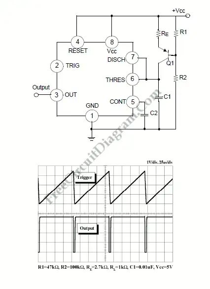

I'd also advocate building a 555 timer sawtooth generator as the basis of your system. Something like this: -
I'd then feed it into a fast comparator and then the use the comparator output to drive the two FETs. The two FETs can be "time segregated" with a small RC time delay on the output of the comparator - the undelayed output and the delayed output would feed an AND gate for one of the gate drives and the the same for the other gate drive but using a NOR gate. Plan on maybe 50ns time delay introduced.
What you get is a half-decent synchronous buck convertor that just needs an input to the other comparator input to get the required duty cycle changes. OK so far? Then you can apply a simple control loop that lowers the 2nd input to the comparator as the input voltage gets bigger. Get this working and then apply another small control loop that actually regulates the PWM with load current changes a tad and this would probably work and no negative feedback involved.
Then, as the final touch, and with care and subtlety apply an overall control loop to keep the output better stabilized but remember, with a sync buck you can pretty much get half-decent stable performance without control loops that use negative feedback - if you are wanting to go this approach I can recommend it.

  • I'm curious as to what advantage the 555 circuit would have over my inverter design in this application - the actual oscillation frequency can be off by almost an order of magnitude without causing much of a problem so the 555's precision isn't needed, also the 555 circuit has a higher part count.

    @MarkKCowan The whole approach is debateable other than as a learning exercise so not knowing what you wanted to learn I threw in the 555 idea but there is an important reason behind it. Your oscillator produces a squarewave but you can use the voltage on the capacitor but it is (A) a non-linear ramp and (B) has undefined thresholds of amplitude that may drift as the device warms up but listen dude, you do it how you feel is right. Non-linearity and unpredictable thresholds - just remember where you heard it first LOL. – Andy aka Nov 25 '13 at 22:19
    The 555 circuit is used to produce a nice smooth ramp for the PWM generation. It is not used for its frequency accuracy; it allows you to turn an analog voltage into a smoothly varying duty cycle. – alex.forencich Nov 26 '13 at 07:11
