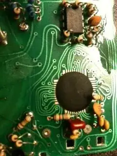

In low-cost mass-produced items I often run into black blobs of what looks like resin applied directly on top of something on the PCB. What are these things exactly? I suspect this is some kind of custom IC that is layed out directly on the PCB to save on the plastic housing/connector pins. Is this correct? If so, what is this technique called?
The Blob
This is a photograph of the inside of a cheap digital multimeter. The black blob is the only non-basic piece of circuitry present, along with an op-amp (top) and a single bipolar junction transistor.

It's called chip-on-board. The die is glued to the PCB and wires are bonded from it to pads. The Pulsonix PCB software I use has it as an optional extra.
The main benefit is reduced cost, since you don't have to pay for a package.

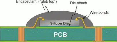

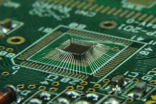

Like Leon said the techniques is called Chip-on-board (COB). You do exactly the same to bond the die directly to the PCB as you would to bond the pins in an IC package. Savings: no package needed. (You could say no soldering also, but that has to be done anyway, so that's not really something you save on).
COB is not cost-effective for small series, and with a few exceptions you will only see it on mass-produced products (100k~1M/year).
The blob is an epoxy resin to protect the IC with the bonding mechanically; the bonding wires are very thin (as thin as 10\$\mu\$m for gold wire) and therefore extremely fragile. Another form of protection it offers is reverse engineering protection. This is not fool-proof (the resin can be removed), but it's a lot harder to reverse-engineer than simply desolder an IC.
