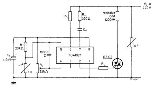

I once made a small oven to dry my photosensitive lacquer PCBs. It was basically a matrix of 1W resistors directly 230V AC powered. I mounted the resistors 1cm above a PCB so that the air could flow freely around them and the heat was distributed well without hot spots. This heater was temperature controlled by a (unfortunately long obsolete) TDA1024 + NTC temperature sensor.
The TDA1024 can be replaced by a transformerless power supply to feed a comparator. My thermostat was set at a fixed 50°C, but with a potmeter you can vary the temperature.
