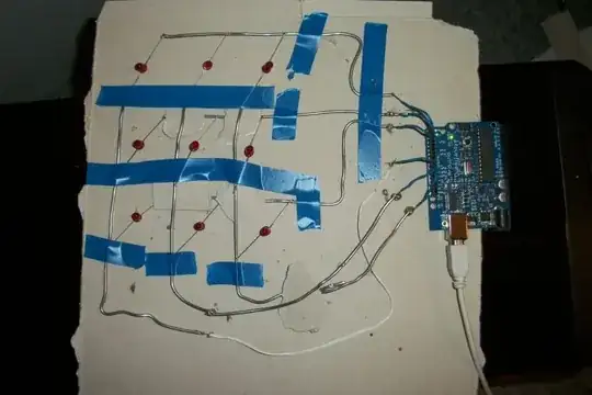

i am trying to get a 3x3 matrix with multiplexing up and running. here is my setup:
alt text
i have connected each rows cathodes and each columns anodes and connected that one to pins 0,1,2 resp. 8,9,10
the only thing i can get to light is the lowest row, but if i want to light the middle row for example with this:
digitalWrite(8, HIGH);
digitalWrite(9, HIGH);
digitalWrite(10, HIGH);
digitalWrite(0, HIGH);
digitalWrite(1, LOW);
digitalWrite(2, HIGH);
nothing happens.
is my wiring setup wrong maybe?

    are you sure you've got the polarity of all your LEDs right? – vicatcu Jan 15 '11 at 21:23
    do you have the requisite pin modes set to output? e.g. pinMode(8, OUTPUT); pinMode(9, OUTPUT); pinMode(10, OUTPUT); pinMode(0, OUTPUT); pinMode(1, OUTPUT); pinMode(2, OUTPUT); – vicatcu Jan 15 '11 at 21:24

Here's a sketch of what you've described for clarity and benefit to others:
Good things to do at this point:
  • Make sure you have current limiting resistors in series with each LED. 560Ω will limit to ~6mA. If these are not presently in place, some LEDs may be burned out, so check them. The ATmega128/328 (whichever is on your board) is limited to *20mA per pin**.
  • Verify that the pins are actually going high or low when you program them to do so, with a voltmeter or logic probe.

    One resistor for each row driver pin, and one resistor for each column driver pin (in this case, 6 resistors) will work great, whether the software does row scanning or column scanning or both. Most LED matrix array only put resistors on the column driver pins, or only put resistors on the row driver pins. (In this case, 3 resistors). That works OK as long as the software and the hardware agree on whether you are doing row scanning, or doing column scanning. – davidcary Apr 01 '11 at 22:09
Without current limiting, you are counting on the micro to limit the current. By turning on several outputs at one time it is consuming a lot of current. I would add 3 resistors to the high bus, 330-560 ohms to the outputs on 8, 9, 10. Turn on only one led at a time. If you need the appearance of several led's on at one instance you can clock the outputs faster in succession.

I don't think you can multiplex like this. You are using all those pins as outputs i.e. digitalWrite(X, HIGH) makes the output of pin X +5 volts. To use two outputs together you need some kind of switch (e.g. an AND gate or some configuration of transistors). I'd say you'd be better off using a shift register (3 inputs to 8) of just use 9 output lines from the board, one for each LED, then write the code for controlling the matrix.
Hope this helps :)
Your setup looks correct. However Aruino digital pins 0 and 1 are also serial in/out. If you are also using serial communication you cannot use them as digital input. Try using other pins.
