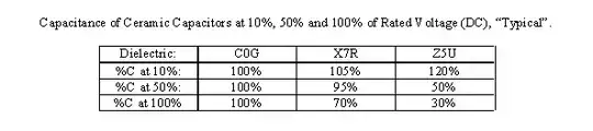

This page has the following table:
alt text

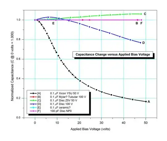

So, if the 22uF is a 20% tolerance part such that is may actually be 17.6uF (-20%), and it is really 15uF (-15%) due to heating, it may be reduced to ~10.5uF (-30%) near its tolerance or ~14uF (-5%) near its operating point. To reduce the effect, use a higher breakdown value capacitor.
Although this webpage tests much higher breakdown voltage ceramics, the results are illustrative: alt text
