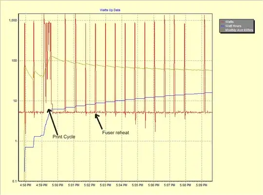

Laser printers have very high peak power needs, manufacturers tend to quote average power usage.
Power consumption   135 watts
During Printing: At nominal line voltage.
  Model A (120V): Maximum of 700 W, Average of 210 W
  Model AB (240V): Maximum of 625 W, Average of 210 W
Inrush Current: (Duration: significantly < 1 second)
  Model A  (120V): 23 A peak (20 deg C, from cold start)
  Model AB (240V): 40 A peak (20 deg C, from cold start)
See https://superuser.com/a/466645/52492
700 W from 12V is 58 Amps (+30% for inverter inefficiency?). You may need to run heavy cable to the vehicle battery (via a suitable fuse). If averages are a guide, your laser printer may have 2.5 times the peak power needs as quoted in this example.
