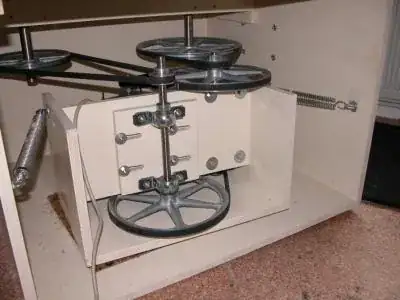

Here are some images of previous machines made by other folks. The front/right/outside:
The back/inside, with the powerhead module, and the motor almost completely hidden behind the central plate of the powerhead (see the AC cable going to the motor over that plate):

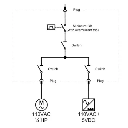

I want to do the 110 V AC part "nice", or "by the book". Near the front/right corner (closest to camera in the first image) I want to add a panel (a small box), jutting out of the big box, containing: the main AC switch, a 16x2 LCD and microcontroller, and perhaps a circuit breaker.
I want the main AC cord to go inside the machine, lay close to the bottom edge back-to-front, then up the front/right edge, come out of the box through a hole, and into the front panel. There, it should go into the main AC switch. From there, it should split in two:
One branch should go into the circuit breaker, then back into the big box through a hole, and then into a regular 110 V AC wall socket mounted inside the big box. The powerhead should plug into that internal 110 V socket, for easy removal (the pulleys on the powerhead need to be adjusted or changed periodically).
The other branch should go into a 5 V "wall wart" supply, and then into the microcontroller connected to the LCD display. All of this branch should stay inside the front panel.

I assume there are some rules to follow when designing the AC part for a machine like this, but what are those rules? In terms of parts and components - should the internal AC wall socket be contained in a box of sorts? Should I run the AC cables inside conduits? (and what kind?)
I assume the rules can't be too different from building a house "to code".
