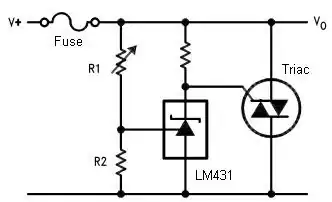

However, there is also overvoltage protection in the car's electronics, most commonly in the form of a crowbar circuit:
Here, the LM431 and triac normally do not conduct. However, if the voltage becomes higher than a threshold determined by the designer, the LM431 triggers, in turn triggering the triac. The triac essentially shorts out the power supply, as if someone threw a crowbar across the rails (thus the name of the circuit). This brings the voltage down, and the excessive current blows the fuse, disconnecting the power source and isolating the fault.
The solution is to put a snubber across the motor, providing a path for the current associated with the magnetic field collapse that isn't through the protection circuitry. In this application, the snubber can be a simple flyback diode. I'm guessing that your car vacuum was manufactured in China and was very inexpensive. By the sounds of it, they could not justify the cost of a power cord of significant gauge, so I doubt they could justify a diode, or the engineer to tell them that it's necessary. Alternate solution: buy a less crappy vacuum.
