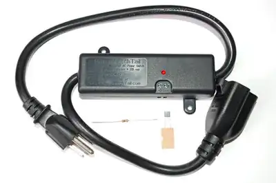

If you are in any doubt about dealing with mains power - don't do it.
You might want to consider a ready made unit like this one from Adafruit:
https://www.adafruit.com/index.php?main_page=product_info&cPath=44&products_id=268
