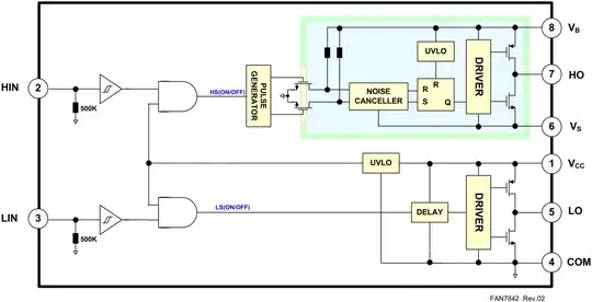

For example, consider FAN7842.
Typical application circuit from its datasheet:
And its functional block diagram is:
I have two questions:
1) Is it possible to use a P-MOSFET in the place of Q1 by modifying this circuit as little as possible?

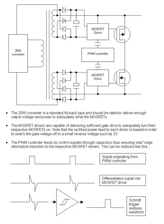

My preference is to use P channel FETs topside. I schemed up a high power push-pull output based on this. t some point in the near future I hope to get it working: -
