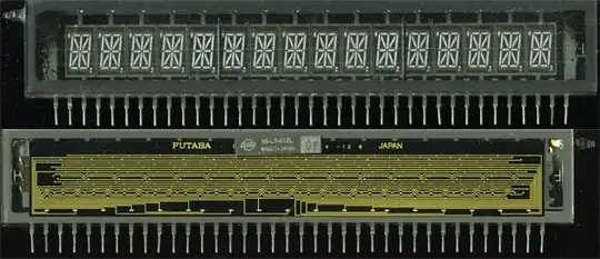

In a box with old components I found a 16 character, 19-segment Futaba VFD:
alt text
I would like to use it for "something" but I haven't the foggiest how to drive such a display. Even the filament is an unknown factor to me. The device dates at least from the early '90s. I guess at that time there were drivers for it, but I don't know if this kind of display is still being designed-in. Information about a driver would be nice, as would some schematic about the whole. (For example: What voltage does the filament require with respect to the driver voltages?)

  • Yes, and it's rather big too: 21cm long, character height 12.7mm (1/2"). I think it was used in cash registers or something like that. – stevenvh Dec 23 '10 at 19:26

  • Given the layout, I'd also say it's from a cash register (POS terminal). In many types it can be hard to divine the pinout and it doesn't help that many are manufactured by the very unhelpful Noritake Itron. Having a datasheet always helps :) – XTL Feb 22 '13 at 12:38

Now, since your display has control grids (the rectangular mesh sections above the digits), there is another thing required to drive your VFD.
Basically, it behaves very similar to a multiplexed display. Every segment in every display is connected in parallel. Therefore, if you leave all the control grids floating, any signal you drive the display with will be present on every character.
By driving all the control grids but one more negative than the filament/cathode, only that digit will be active, since the control grids will prevent current from the cathode from reaching any of the other characters.
VFDs use directly heated cathodes, so the cathode is easily visible. The three very fine horizontal wires running the entire width of the display are the cathode.
I would guess that the filament probably takes about 2-6V at a hundred ma or so. It should NOT glow visibly at all. The anode voltage should probably be about 30-60v, and the grid a few V- (though I think driving the grid positive might also work, if it successfully depletes the available local electrons. I've only played with single digit VFD tubes without grids).
Your best bet is to trace out the connections on the back of the unit, and try powering on a bench supply.
The yellow traces you see on the rear-view are the internal electrical connections. You should be able to figure out the pinout from them.
The pin on each end is almost definitely the filament connections.
If you have a few bench power-supplies (three, though I think you could manage with two), you should be able to get at least part of the display to light up without too much trouble. Getting it to display useful numbers is another matter.

    Looks like they still list the segmented VFDs on their website. The 16 character alphanumeric display is here: http://www.futaba.com/products/displays/full/30-full.pdf – markrages Dec 23 '10 at 18:01

HOW TO FIGURE OUT THE PINNING
The connection for the filament are usually the two outer most pins, but in your case it looks like it is only the first and last pin. Check with an ohm-meter (should be something below 20ohm). The mesh gates are usually counting from one end and the multiplexed segments from the other.
When I salvage VFDs from DVD players and alike This works 90% of the time.
Connect +3.3v DC on one filament end and ground to the other. Use a current limiter and raise it slowly. If the filament start to glow the voltage is to high! The current should stabilize below 30mA depending on the VFD size (filament length) and voltage.
Connect +12v DC to a mesh-gate (start from one end) and +12v DC to a segment (start from the other end). Keep moving from pin to pin at the segment end to see if some segments light up. I usually use a 1K series resistor to limit the current if I should hit any ground pin. If nothing happend, move to the next the mesh-gate and repeat.
If nothing shows, try to increase the voltage on the filament a bit (it should not show any signs of glowing!) or the gate and segment voltage (segment and mesh-gate should be the same voltage).

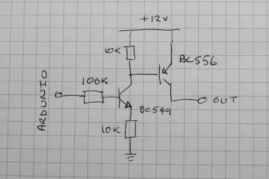

Now when you know how your VFD should be connected you need to drive the mesh-gate and then each segment with the +12. Then change mesh gate and then drive the next segments. Repeat thisat 50 or 100 times a second to get a steady display without flickering.
Since your controller propably use 3.3v or 5v you nedd to either use a Step-Up or Booster to convert the power to 12v (or just use an external 12v power). Use a PNP transistors for each segment and mesh-gate to turn on +12v
This was some image I found on Google that shows how to drive one segment/gate (why draw one identical if someone else already done it, it's a quite standard solution) Schema
The first transistor is a level-shifter to drive the second transistor, the driver transistor. However, the "driver" transistor can be a very small one, there isn't many uA on that line. Connect the segment/gate to the "Out" terminal.
