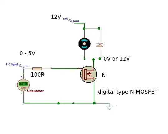

The 'improved' MOSFET circuit.
We could eliminate the transistor by using a digital N MOSFET type - it only needs the 0-5V signal from the PIC output to operate and isolates the PIC output pin from the 12V supply.
When the PIC output is HIGH the MOSFET is turned ON, when it is LOW the MOSFET is turned OFF. This is exactly the same as the original P MOSFET circuit. The series resistor has been made smaller to aid the turn ON, turn OFF times by charging or discharging the gate capacitance more quickly.
The choice of device is basically down to your design needs although in this case the digital type N MOSFET wins hands down for simplicity.

  • In the 'improved' circuit, shouldn't there be a resistor between the gate and the ground to make sure the FET goes low again after the microcontroller brings the voltage back to 0? – captcha Sep 02 '14 at 22:49
    @captcha The output pin of the pic effectively grounds the gate through the 100R resistor and turns the MOSFET off. Adding an extra resistor would have no effect. – JIm Dearden Sep 03 '14 at 09:53
  • Wow, this is great news as I have always been including this resistor with my mcu designs. When space is at a premium every bit helps. Thanks! – captcha Sep 03 '14 at 22:08
  • P channel fets have higher ON resistance due to the lower hole mobility – Autistic Mar 19 '15 at 02:35
  • @JImDearden - (Please keep in mind I'm a newbie and trying to learn from this) Is the 100 Ohm resistor eliminating what's called "leakage" current and voltage? How did you pick the value? – diegoreymendez May 07 '17 at 06:01
    @diegoreymendez No. The gate-source is effectively a 'capacitor' so a small series resistor (in this case 100 Ohm) limits the initial charging/discharging current from/to the pic output. It also prevents any possible oscillation due to inductance in pcb track/connecting wire. Ignoring the I/O resistance (which would increase the resistor value) the peak current is a simple Ohm's law calculation. 5/100 = 50mA. After 5 time constants this is virtually zero. If the input capacitance is 2000pF, time constant = (CR) = 0.2uS. Like most design calculations its a simplification and a compromise. – JIm Dearden May 07 '17 at 10:44
