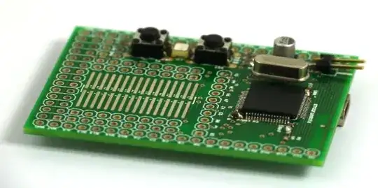

As the other answers say, most uC's come with toolchains that support C and some other similar languages, because larger languages, especially those with garbage collection, are very resource hungry.
But, in the spirit of Atwood's Law: "Everything will eventually be ported to Javascript", I give you the Espruino, "The world's first JavaScript microcontroller for beginners or experts.":
Macke
  • 127
    Amusing Note: That uC does not natively execute Java. It is a standard uC that just happens to have a Java interpreter pre-loaded into it's Flash. The uC executes "machine code", just like any other uC. –  Sep 08 '13 at 06:19
  • This is no less an answer than those that mention Basic interpreters however. As for the device itself, it's the sort of project which will live or die on the capability of its software stack, and it appears that there is an unsupported release which one can try to get running on the discovery boards which are both already available and cheaper than the kickstarter proposal. – Chris Stratton Sep 08 '13 at 07:16
  • @ChrisStratton I didn't say it was "less of an answer", I didn't downvote it. I called it an "amusing note". Don't be so argumentative. Also, if you do an At-Username when you reply then the person you are replying to will get a notification. Otherwise, your comments could easily get overlooked. –  Sep 09 '13 at 00:36
    @David Kessner: This is about "JavaScript", not "Java". Both are quite different languages. – Curd Sep 09 '13 at 08:50
