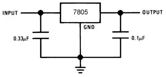

I would use a 7805 to get 5 volts simple circuit. Here is a image: 7805
idea: please make sure that caps are ceramic/polymer caps. The ceramic caps only have low ESR value. specially the right hand one.

    And for reference, here is how to decide what value to make the capacitors http://electronics.stackexchange.com/questions/8121/capacitor-sizes-for-7805-regulator – Kellenjb Dec 21 '10 at 00:23
    +1 since the 7805 is simple and good for rapid prototyping. But remember that this solution will drain the battery really fast! So if you are thinking about power management go with another solution. – Johan Dec 22 '10 at 12:13
  • What would be the ground current for a 9v input with an LM7805? – Isaac Sutherland Dec 27 '10 at 23:47
  • @IsaacSutherland, input current = output current on a linear regulator(minus a small leakage). This means that if you are pulling 30mA at 5V you will see at 30mA at 9V as your input. This should explain the inefficiency as your efficiency is approximately Vout/Vin. – Kortuk Mar 01 '11 at 06:03
    @Kortuk, ground current is related to power wasted irrespective of load. According to the Fairchild LM7805 datasheet, graound current for lm7805 is 5mA typ, 8mA max, and doesn't change much with load or input voltage. This current will drain a standard 9V Energizer 522 flat in about 100 hours, so if the circuit will be on standby it would be better to use a more modern regulator with lower ground current. – markrages Mar 01 '11 at 07:40
    @markrages, I did not know the term ground current and took a shot at answering since he asked a while ago. Thank you for taking the time to clear that up! – Kortuk Mar 01 '11 at 07:54
  • 7805 regulators are stable with capacitors of any ESR, they do not have to be ceramic or poly. Realistically, I'd probably just use two 0.1 uF caps (since they're so cheap), and maybe a big electrolytic on the input, if the wires to the battery from the regulator are particularly long/thin. – Connor Wolf May 24 '14 at 10:18
  • You should consider adding a heatsink to the regulator, especially when converting 9V to 5V and especially if the circuit uses a lot of current. –  Oct 29 '16 at 03:43

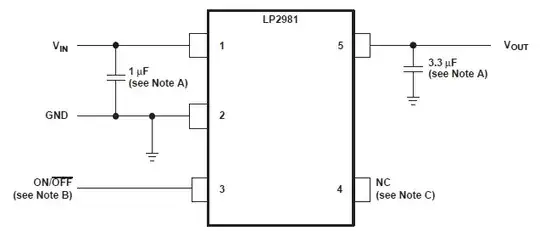

Since you want to power from a 9V battery we have to look out for possible current losses. While a three-legger like LM7805 may be an obvious choice, this regulator has a ground current of 8mA maximum. An LDO (low drop-out) regulator typically needs far less, e.g. the ground current of an LP2981 is only 800\$\mu\$A maximum. That's only 10%!
LDOs are as easy to use as an LM7805. The output capacitor is a bit larger, though, important for stability.
edit
Johan wanted an example:
alt text
If not used, the ON/OFF input must be tied to \$V_{IN}\$. The output capacitor value of 3.3\$\mu\$F is the minimum required for stability. "More capacitance provides superior dynamic performance and additional stability margin" (dixit NS)
edit 2
You can even save more power, but it's probably not worthwhile; your motors may consume a lot more than the LDO's 800\$\mu\$A.
Anyway, there are LDOs with < 1\$\mu\$A ground current, like the Seiko S-812C50. Input voltage up to 16V, output voltage is selectable from 2V to 6V in 100mV increments. Output current is limited, however, to 50-75mA.

  • Where the heck do you get one of these (the LP2981) that can be used on a breadboard? I can only find tiny pcb versions of this regulator. – user3308807 Jul 09 '20 at 05:57
