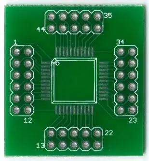

For SMD there are adapter boards SMD-to-PTH, like
SMD adapter
Soldering the parts takes some exercise. You may want parts with a 0.8mm pitch instead of the higher density 0.5mm pitch. The latter you'll find mostly on devices with 48 pins or more.
The other option is that you design your own boards for which you need an EDA (Elecronic Design Automation) package like Eagle. This has a free version with limitations, or a full version which has to be payed for. This design has a long learning curve. When you designed stuff this way you have to option of etching your own board or have it produced by a PCB production shop. The latter is the best choice for quality, the DIY is cheaper and faster.
For starters I recommend the adapter boards I mentioned at the beginning of this answer.

There are 3 approaches to converting a difficult-to-work-with package into something easier to use:
  • generic SMD-to-PTH adapters, as stevenvh mentioned. For example, it seems that lots of microcontrollers come in a 44-pin TQFP package; you can solder any one of them to a generic 44-pin TQFP-to-PTH adapter. A few of them are "breadboard compatible". Alas, this usually requires you to find someone capable of doing this soldering.
