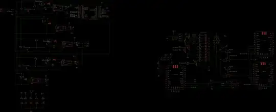

Here is my power schematic:

    I would suggest you redraw your diagram with a white background and try and condence it in size so that it becomes readable. – Andy aka Aug 19 '13 at 11:11
  • @user26129 the off voltage with nothing connected is 0.09V.
    Andyaka the schematic is too big to fit here, that's why I put a link to the full size image.
    – Tiago Queiroz Aug 19 '13 at 13:01
    Many devices are not rated for having voltages on their I/O lines above that of their supply lines, or at least not above it by more than a diode drop. What tends to happen is that the I/O line then pulls up the power supply line through the protection diodes, but this can (amongst possible worse things) exceed the current rating of the protection diodes. It's not entirely clear if the pi is the source of the power here or merely a conduit for it. If it's the source, and you are talking about 3.3v serial signals from the MCU, you can probably software configure them as GPIOs and drive low. – Chris Stratton Aug 19 '13 at 14:10
  • @Andyaka I took the image and applied a negative filter and changed the hue so that it has a white background but still has the same colors. I will upload it. – Christian Sirolli Apr 25 '17 at 14:41
Most of new ICs (analog or digital) have ESD protection diodes which are diodes connected between the input pin and the supply rails, their main job is to clamp the input pin voltage between the supply rails in the event of a voltage surge, see
How Diode Clamping Works
these diodes have low current rating so if you continuously load them with enough current they can be damaged,
Since you haven't supplied voltage to the circuit, your circuit can be turned on
through the ESD diodes on the data lines, the simplest way to protect these diodes and also fixing your problem is placing a resistor on your digital lines, if you don't have high baud rates 1kohm should be a good starting value
