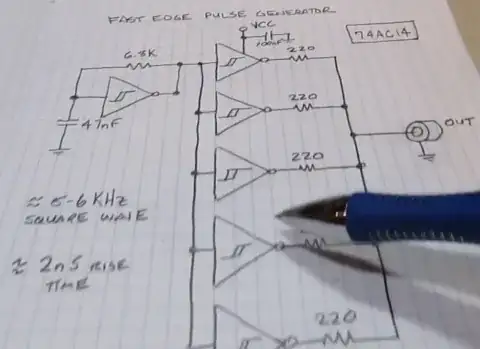

In W2AEW's videos, he builds a simple fast edge pulse generator using a 74AC14 hex Schmitt trigger (inverting) and demonstrates how to use it for capacitance and inductance measurements as well as a time-domain reflectometer.
W2AEW's Schematic

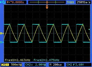

I am measuring the input and output of the first Schmitt trigger with a 100MHz digital oscilloscope, with the same value components (6.8kΩ resistor; 0.047μF capacitor) at 5V DC.
FEP at 200us per div
First, the frequency is about 2.5 kHz, not 6 kHz as in W2AEW's example. I'm not sure what is causing the substantial difference. But for this application, the frequency is not as important, so I haven't worried about it.

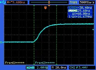

Second (and what this question is about), when I look closely at the rise time of the square wave output, I am measuring something like 60ns, instead of <5ns as expected.
FEP at 20ns per div
I realize that measuring something as fast as 2ns with a 100MHz scope is not ideal (I assume I would want something like 500MHz to obtain more detail), but I didn't expect such a difference.

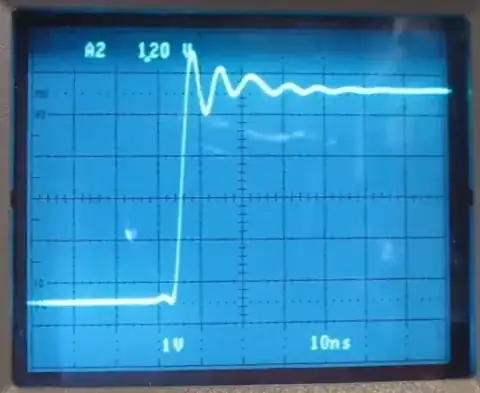

W2AEW's edge, measured with a 350MHz analog scope is quite different looking:
W2AEW at 10ns per div

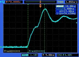

Per Oli Glaser's answer, the reason for the delay is that the probes were set to 1x rather than 10x, and limiting bandwidth, possibly as low as 10MHz. By setting the probes to 10x, the waveform immediately starts to resemble what it should (~13ns). The extra delay and capacitance is probably because I am using a breadboard and some unshielded jumpers to connect to the oscilloscope probes.
Here's the resulting improved display:
FEP at 5ns/div and probes 10x

    Do you have your probe on x10? – Oli Glaser Aug 17 '13 at 22:01
    In the pic with the 60 ns rise time, at the bottom, it says Ch2: 2.00VB" (roughly). Does the "B" in that mean that the bandwidth limiting function for that input channel is turned on? –  Aug 17 '13 at 22:02

  • 0.047μF is 47nF ... the schematic shows 4.7nF. That could account for the unexpected frequency you are seeing. – aja Aug 17 '13 at 23:41
  • @Oli No the probe is x1. – JYelton Aug 18 '13 at 00:36
  • @David Yes, in fact. It was limited to 20MHz in the picture. It is quite similar at 100MHz, however. – JYelton Aug 18 '13 at 00:36
  • @aja I will double-check the video, I thought it was 47nF. – JYelton Aug 18 '13 at 00:39

Set your probe to x10.
At x1 setting, there is a lot more capacitive loading, and the bandwidth is severely reduced.
See the specs for this typical passive probe below, and look at the difference between the risetime/bandwidth at x1 and x10 settings.

  • This is exactly the problem. At 10x setting, the waveform is much closer to the expected (13ns or less). The breadboard and unshielded little test jumpers I am using are certainly responsible for the extra delay/capacitance. – JYelton Aug 18 '13 at 01:18
