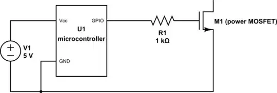

Someone told me that this circuit has "poor gate drive capability":
schematic
What exactly does that mean? I tested it with an LED as a load for M1, and the microcontroller is able to turn it on and off just fine. Under what circumstances is poor drive capability a problem? How do I improve it?

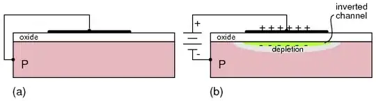

The answer is at the end, but, just in case you are not familiar with the concept of MOS capacitor, I'll do a quick review.
MOS Capacitor:
The Gate of MOSFET transistor is essentially a capacitor. When you apply any voltage to this capacitor, it responds by accumulating an electrical charge:
The charge accumulated on the Gate electrode is useless, but the charge under the electrode forms a conductive channel which allows for a current to flow between Source and Drain terminals:
The transistor switches ON when the charge stored in this capacitor becomes appreciable. The Gate voltage at which this happens is called the Threshold Voltage (essentially it is the Gate-to-Body voltage which is relevant here, but let us assume that the Body is defined as zero potential).

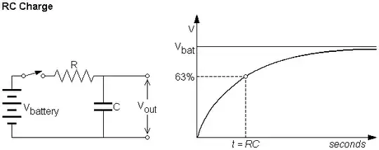

As you may know, charging a capacitor through resistor takes time (there is always some resistance present, even if the schematic does not contain resistors). This time depends on both capacitor's and resistor's value:

  • The higher the externally applied voltage, the shorter it takes to switch the transistor ON.

When people say "poor gate drive capability" they mean that the turn ON and turn OFF times of the transistor in given configuration are too long.
"Too long compared to what?" you might ask, and this is the most important question to ask. The required turn ON/OFF times depend on many aspects, which I don't want to get into. Just as an example, think of driving the transistor with a periodic square wave having 50% duty cycle and period of 10ms. You want the transistor to be ON during the high phase and OFF during the low phase of the signal. Now, if the turn ON time of the transistor in a given configuration will be 10ms, it is clear that 5ms of high phase signal will not be enough to turn it on at all. The given configuration has "poor gate drive capability".
When you used the transistor to switch on the LED, you did not employ high switching frequencies, right? In this case, the switching time of the transistor wasn't of major importance - you just wanted to see that it does switches on/off eventually.

The problem arises when MOSFETs are to be turned ON/OFF at a relatively high frequency. The Miller capacitance introduced into Gate (Cgs) plays an important role then, so that charging/discharging this capacitance at a high frequency requires currents in excess of 1A to be injected into Gate.
At DC and static operation however the drive circuit "sees" a very high impedance load and can easily turn the MOSFET on/off. Just to test and verify, increase the frequency of the GPIO pin in the shown schematic and watch the waveform on Gate of the MOSFET.
