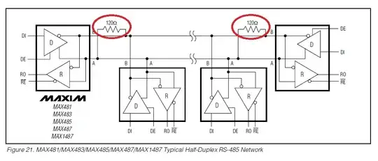

If you aren't using terminators then you should. I've attached a drawing to show what you should do - this makes it a little difficult to put as a comment.
Quite possibly, with the extra loading of the sparkfun breakout board you are just about able to reduce data reflections to an "OK" level.It could also be that the sparkfun output is slew rate limited and this would reduce the effect of reflections.
What type of cable are you using i.e. twisted pair with Zo = 120ohms, possibly screened/shielded etc..

  • Hi Andy, The cable is Zo=120Ohm, twisted pair, shielded When I was using the MAX487ECSA+, I had a termination of 120Ohm. I tried with and without termination, to no avail.
    With the sparkfun board, it has a termination of 220Ohm. It worked without any termination on the other end
