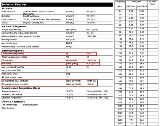

EDIT This is about where the turning points are between audio (complex) impedances and HF resistive impedances. For a start, here is a good spec for RG-58. Below are the salient points: -
Notice the bottom two data highlighted in red - this is the inner and outer DC resistance per 1000ft - a total of 54\$\Omega\$ per 1000ft loop (304.8m). This equates to 0.1772\$\Omega\$ per metre.
For |jwL| to equal 0.1772, the frequency will be \$\frac{0.1772}{2\Pi L}\$ and if L = 0.25uH then F = 113kHz. Ten times higher in frequency (1.13MHz) and Zo pretty much approximates to \$\sqrt{\frac{L}{C}}\$ i.e. is 50\$\Omega\$ resistive.
For higher frequencies, Zo is a reliable resistive quantity, for frequencies down between 10kHz and 1MHz it's a mish-mash and at audio frequencies below 10kHz it becomes what is telephonically known as a "complex impedance" where the impedance is largely determined by series resistance and parallel capacitance and the impedance phase angle is about 45º because \$\sqrt{-j}\$ is 45 degrees.
