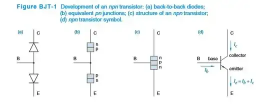

I believe that you were led to ask this question due to something like this picture:
This is a standard practice of teaching the basics of BJT, but it can confuse someone not familiar with semiconductors theory in details.

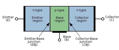

NPN in forward-active mode of operation:
The most "useful" mode of operation of BJT transistor is called "forward-active":
NPN is in forward-active mode when:
  • Base-Emitter junction is forward biased (usually at \$V_{BE}\approx 0.6V\$)
  • Base-Collector junction is reverse biased (\$V_{CB}>0\$)

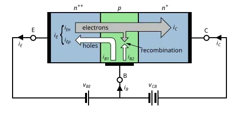

Due to Base-Emitter junction being forward biased, there is an injection of electrons from the Emitter to the Base (\$I_{E_n}\$ in the image above), and the simultaneous injection of holes from the Base to the Emitter(\$I_{B1}=I_{E_p}\$ in the image above). Emitter region (\$n^{++}\$) is much more heavily doped than the Base region (\$p\$), therefore the current due to electrons injected into Base is much higher than the current due to holes injected into Emitter.
Note that the holes injected into Emitter are supplied from Base electrode (Base current), whereas the electrons injected into the Base are supplied from Emitter electrode (Emitter current). The ratio between these currents is what makes BJT a current amplifying device - small current at Base terminal can cause a much higher current at Emitter terminal. The conventional current amplification is defined as Collector-to-Base currents ratio, but it is the ratio between the above currents which makes any current amplification possible.
Due to injection of huge amount of electrons from Emitter, electrons tend to diffuse through Base to Base-Collector reverse biased junction. Once an electron reaches there, it is swept across the Collector-Base depletion region and is injected into Collector thus contributing to Collector's current (\$I_C\$ in the image above).
Now, if all these electrons injected from Emitter could diffuse to the reverse biased Base-Collector junction without being subject to other effects - there were no importance at all to the width of the Base region. However, there is recombination going on in the Base.
In recombination process the injected electrons meet holes and "neutralize" each other. The injected electron is "lost" in this process and will not contribute to the current at Collector terminal. But wait, charge conservation requires that the hole which recombined with the injected electron will be supplied from somewhere, right? It turns out that the recombining holes are also supplied from the Base terminal (\$I_{B2}\$ in the image above) thus increasing Base's current and decreasing the Emitter-to-Base currents ratio (which represents transistor's current gain, remember?).
The above means that the more electrons recombine during diffusion through Base region, the lower the current gain of the transistor. It is up to manufacturer to minimize the recombination in order to provide a functional transistor.
There are many factors that affect recombination rates, but one of the most important ones is Base's width. It is evident that the wider the Base, the more time it will take to injected electron to diffuse through the Base, the higher the chance that it will meet a hole and recombine. Manufacturers tend to make BJTs with very short Base's.
So, why can't two PN diodes back to back function as a single NPN:
The above discussion explained why Base must be short. PN diodes (usually) don't have this short regions, therefore the recombination rate will be very high and the current gain will be approximately unity. What does this mean? It means that the current at "Emitter" terminal will be equal to the current at "Base" terminal, and the current at "Collector" will be zero:
schematic
The diodes are functioning as standalone devices, not a single BJT!
