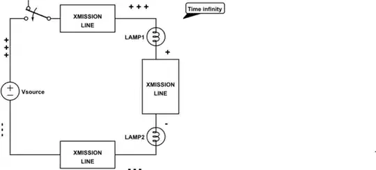

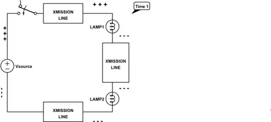

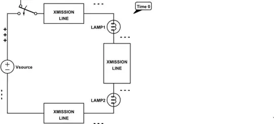

Case 1: ground connected initially
In this case, the circuit nodes are charged to ground voltage initially.
schematic
When the power supply is connected, a voltage wave starts from the power supply terminal as electrons are sinked by the power supply. LAMP1 is the first to have a voltage difference across it, so it will light up first.
schematic
simulate this circuit
Once the voltage wave has reached the ground terminal, a portion of it may reflect back and travel the opposite direction (see ringing). Assuming the absolute value of the reflection coefficient is less than 1, the wave will eventually disappear after an infinite time, and the circuit will stabilize to a constant voltage at each node of the circuit. In practice, the wave should decay to have a negligible effect nearly instantaneously.

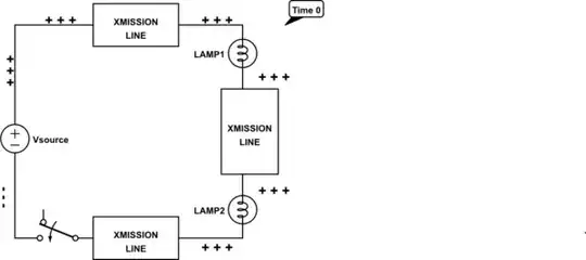

Case 2: power connected initially
In this case, the circuit nodes are charged to power supply voltage initially.
schematic

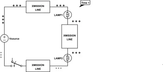

When ground is connected, a voltage wave starts from the ground terminal as electrons are sourced from ground. LAMP2 is the first to have a voltage difference across it, so it will light up first.
schematic
Once the voltage wave has reached the power supply terminal, again, a portion of it may reflect back and travel the opposite direction before the circuit stabilizes to constant voltages at each node.
