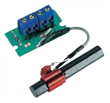

What I find the nicest solution, however, is to add an atomic clock receiver module (WWVB for North-America, DCF77 for Europe), and resync once a day or so. The picture shows an miniature DCF77 module from Conrad.
