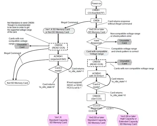

Adding to @vaxquis excellent answer, I'd like to quote the corresponding chart from the "Physical Layer Simplified Specification Version 4.10, ©Copyright 2001-2013 SD Group (Panasonic, SanDisk, Toshiba) and SD Card Association" (Figure 7-2: SPI Mode Initialization Flow):
SD Card SPI Init Sequence
Here you can see which commands to send in which order and what the responses tell us about the type of card. I think it is desirable that a device supports as many cards as possible; and as long as it comes to the basic operations of reading and writing blocks of 512 bytes, that should be doable for at least all V1.x and V2.0 SD and HC cards.
