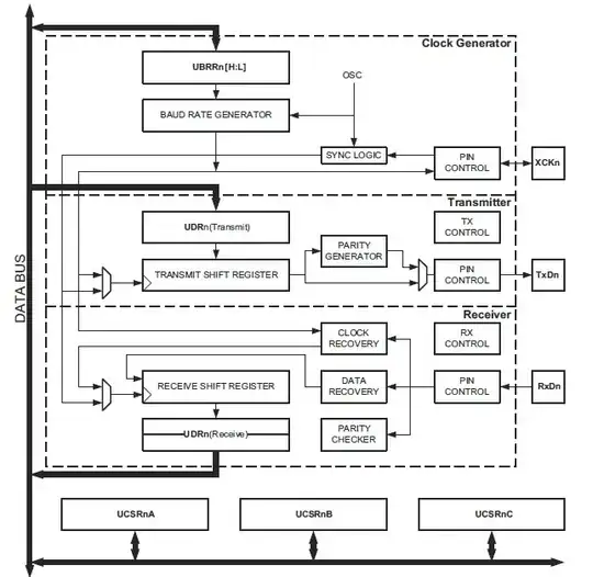

Look at the HW design of the protocol itself:
The HW pieces in bold, e.g. UBRRn, UDRn, UCSRnA, UCSRnB and UCSRnC are registers that you interface to in order to use the USART HW. For instance, you can use the register UCSRnC to control whether or not the USART functions Synchronously or Asynchronously!
